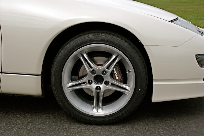

TwinTurbo.NET: Nissan 300ZX forum - The finish is the wheel stripped and sanded to 600 grit,
Subject The finish is the wheel stripped and sanded to 600 grit,
Posted by 240Z FeO2 on September 24, 2011 at 4:59 PM
  This message has been viewed 237 times.
In Reply To Did you just paint those? posted by ZXoltan on September 24, 2011 at 03:39 PM
Message polished with aluminum compound, after which the shine was knocked down with a 3M brown pad.
I was planning on staying with the original finish. However, the wheels I bought had some paint on the inside of the rims about to flake off. I masked the outside, and touched up the paint on the inside, only to pull some of the clear coat off when I removed the tape.
Had I discovered, at that time, what appears to be a match for the OEM Yokohama silver (Nissan Quicksilver Metallic KL2), I would have just repainted them, but by then I had stripped the paint and polished the wheels. And paint AFAIK doesn't stick very well to raw aluminum.
As far as polishing goes, if my wheels are typical, this is a difficult process (at least without good polishing technique) as these wheels have quite a rough finish once stripped of paint.
